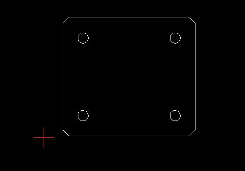

Re: perimeter
Posted: Mon Oct 14, 2019 12:38 am
by libomcad
Komentár 2019-10-14 083323.jpg (7.9 KiB) Viewed 8093 times
for example for example, picture - total line length
Re: perimeter
Posted: Mon Oct 14, 2019 2:40 am
Hi Zdenko,
the perimeter of your object needs to be drawn with a Polyline.
then using the List command (type - list entity information - into the search bar in the help section)
Your should get something like this:
Re: perimeter
Posted: Sun Nov 03, 2019 7:49 am
by CMS Inc
It depends on the objects or entities.
If it's a closed object, if applicable, use PROPERTIES command or AREA command.
If not, then use BOUNDARY command. It will create a closed polyline entity. Then use AREA of selected entity.
