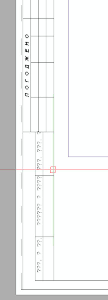

Hi!
Intellicad 9.0 does not see fonts at startup.
I need to restart the program.
text font ISOCPEUR Cyrillic

Go to HELP > Check for Updates.

after upgrade
