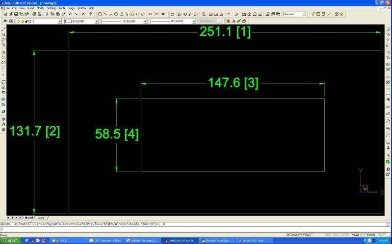

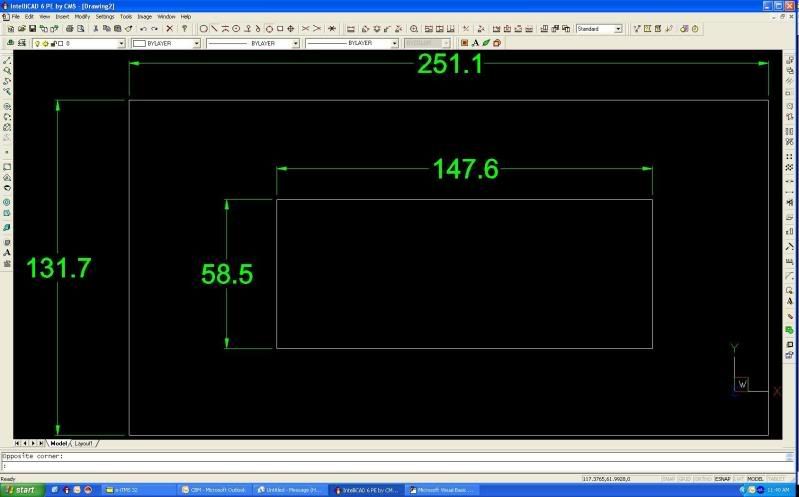

Here are some example before and after pics:
So far i have developed some code that lets me choose 4 dimensions in order of how i need the text overrides, so therefore the first dim i click on gets the text override value "<> [1]", the second dim gets text override "<> [2]" etc... This works fine but the problem i'm having is the dimensions are not updating visualy so to speak. If I double click a dimension it shows under Entity Properties that the text override has been changed correctly.
So far the only way i've found to fix this is by the following two methods:
1) Double click on dimension to bring up Entity Properties. Click Dimension Settings, then click OK without making any changes, then OK on Entity Properties. The override displays now.
2) Another way I can fix it is by going to Apply Styles, select all my Dims, and hit enter to re-apply style.
Is there a way using VBA code to refresh the dims and show the recent changes to the text override?
