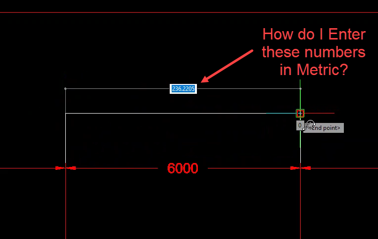

How do I enter lines in metric?

I'm not 100% sure how you are setting up your drawings, however the simple answer is to 'edit' the dimension txt using the text editor.
Personally I avoid editing dimensions in this way where possible, and let the software put the numbers in that it 'thinks' is correct.
If you have drawn it right the numbers will be right.

Warren,
It looks like you imported the drawing to the wrong scale (off by a factor of 25.4 which is inches vs mm), If the drawing is already set to mm you'll have to scale everything by a factor of 25.4 to get it to measure in mm. Or as above, set the measurement variable to mm instead of inches.
