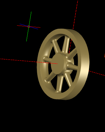

Hi All.....well well well...... thanks to the various inputs from Sin8458 & Spirou4D and having tried countless times I have finally produced something like the intended 3D drawing that is a solid object and will save as an STL file. I think my problem (apart from lack of practice with CMS intellicad) was one of getting the UCS corectly orientated when trying to fillet. Whilst we may not be out of the woods yet I feel a little more understanding of the steps involved and will pay with other shapes. I attahc a screen grab of the finished article. Thanks again to you guys for your help.
Steve, for the moment ignore my email enquiry whilst i practice further.
Thanks
R

Is this what you're attempting to model?
We see no issues creating a 3D fillet on Boolean 3D solid objects, based on CMS IntelliCAD 3D primitives, that are not orthogonal. You'll need to be using CMS IntelliCAD 11.1 PE PLUS software.

Cool wheel!
