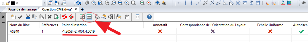

EUREKA I FOUND !
Look the block editor there are a dimension to insertion !
Type 0,0,0 and the block will become normal!
2025-04-26 11 09 57.png (4.24 KiB) Viewed 74933 times
ALL IS OK NOW ! Change the display of the block editor to see the "insertion point" column and correct the point.
And then if the UCS of the block is not where you want, click 2x on the block and change the origin of the block.
I made a lot of test and it's ok now BUT I don't see why the flatshot make this gap for the insertion point and the block UCS.
