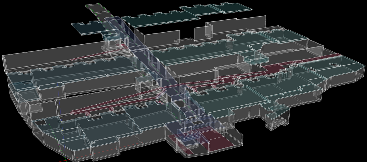

So, your problem is worse, Steve. I certainly don't need, thus far, to resort to more complicated operations than creating solids by extruding polylines and unioning or substracting them; very simple straight prisms operations —it's about defining the geometrical shape of a building structure of reinforced concrete, where almost every shape is said straight prism, a lot of them, though.
This is a general view:

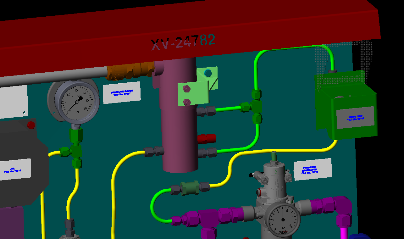

Hi Juan,
NO, I wouldn't say my work is more complicated.
The backplate is just a flat sheet of steel 3mm thick. The mounting holes/slots are just cylinders which are removed from the plate via Subtract.
The backplate itself is a closed plolyline Extruded
The tubework is just circles Extruded along a path (inner wall subtracted from outer wall)
Components are from manufacturers websites downloaded or sent via email request
