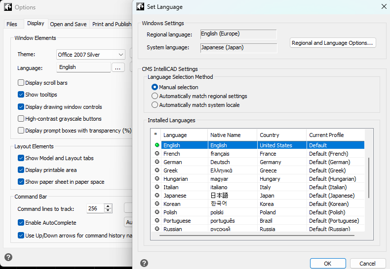

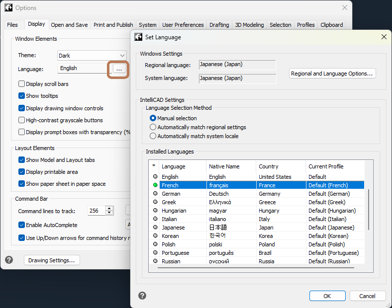

Hi Jeep,
Please use the command OPTION, then go to the tab "Display", click on the "..." button to show the "Set Language", here you can see all the languages of the version.
Here's the "Set Language" UI on the 14.1 version.
