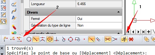

I found a solution for you : you can change GRIPS = 1 as Steve show you.
And when you want use the median of edge, deactivate the snap with the man who run (1)
and choose the snapping to the median point (2) :
