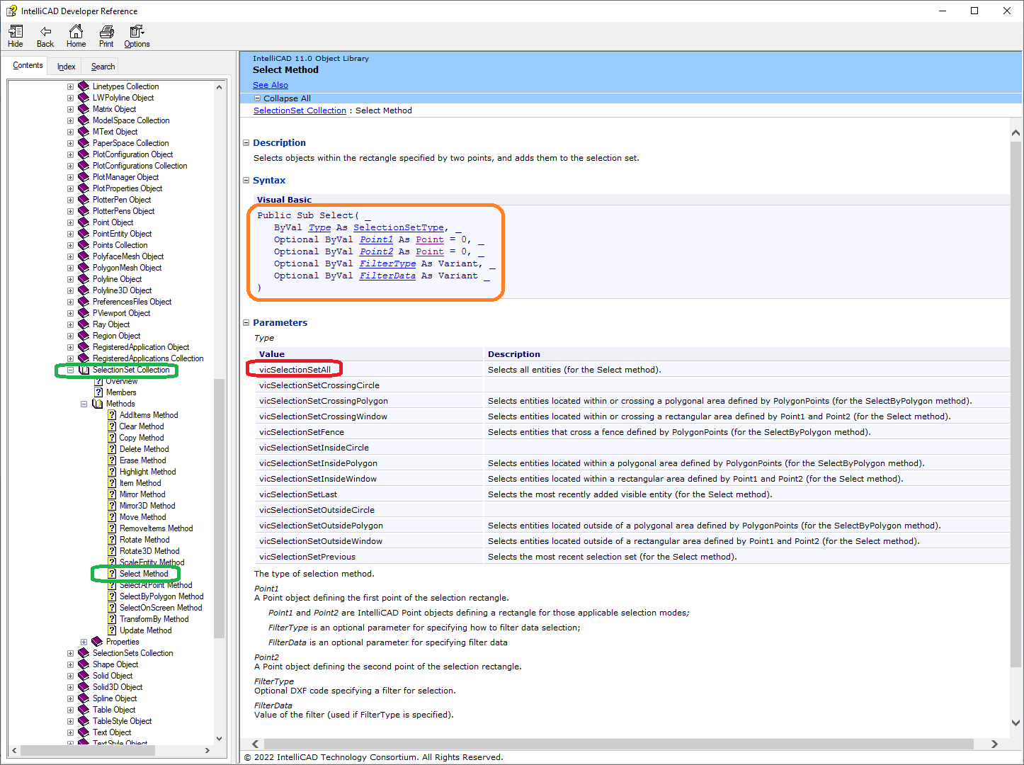

Please refer to the official document and modify it to fix with the IntelliCAD.
Select method.png (130.03 KiB) Viewed 61800 times
Here's the modified function SSetCreate base on your one.

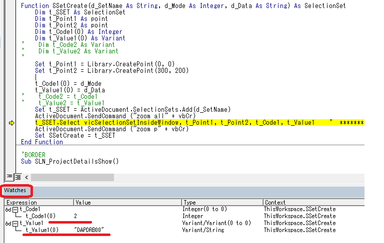

Now, adding a line from 50,50, to 250,150 (within the search window) and the incrementing through the code give:
Sorry not the best image, but
t_SSET now has a count of 1 ? is this correct??

Re: DVB file
#26
Hi Steve,
Please use this function to get the block in the attached drawing.
Function SSetCreate(d_SetName As String, d_Mode As Integer, d_Data As String) As SelectionSet
    Dim t_SSET As SelectionSet
    Dim t_Point1 As Point
    Dim t_Point2 As Point
    Dim t_Code As Variant
    Dim t_Value As Variant
    Dim FilterType(0 To 0) As Integer
    Dim FilterData(0 To 0) As Variant
    FilterType(0) = d_Mode
    FilterData(0) = d_Data
    t_Code = FilterType
    t_Value = FilterData
    Set t_Point1 = Library.CreatePoint(0, 0)
    Set t_Point2 = Library.CreatePoint(12, 8)
    Set t_SSET = ActiveDocument.SelectionSets.Add(d_SetName)
    ActiveDocument.SendCommand ("zoom all" + vbCr) ' zoom to 0,0 12,8
    t_SSET.Select vicSelectionSetInsideWindow, t_Point1, t_Point2, t_Code, t_Value
    ActiveDocument.SendCommand ("zoom p" + vbCr)
    Set SSetCreate = t_SSET
End Function
Re: DVB file
#27
Many thanks Quan, that works :)
