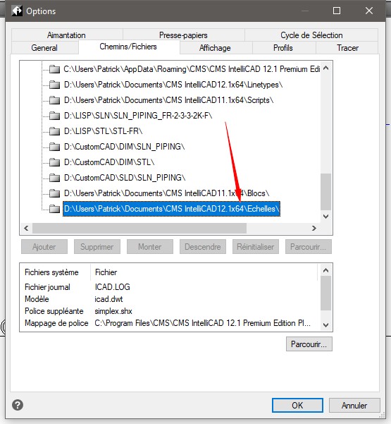

Thank very much. I think we area closer to the solution, but not yet.
I applied your suggestions, and this is the result: The solution works adding my path to the beginning of the support paths, but only, if I delete the original icad.unt form the CMS IntelliCAD folder.
So, still need manual (or human) intervention.
You can make a test doing the following:
  • Make a copy of your original icad.unt
  • Paste the file in to your personal folder
  • Open the new file and add this (2) lines at the end of the file:
*sqmile
=2589988.110336 meter^2
  • open CMS IntelliCAD and add your folder at the beginning of the list as you suggested.
  • Close and open CMS IntelliCAD and do this test:
  • copy/paste the following instruction to the command line and hit the enter key.
(cvunit 500 "acre" "sqmile")
if 0.781250 shows, is working.
if not, rename the original icad.unt to icad.unt.org located in the CMS IntelliCAD folder, and try again.

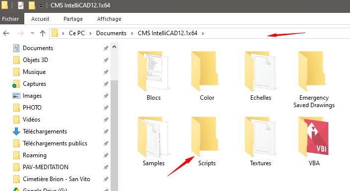

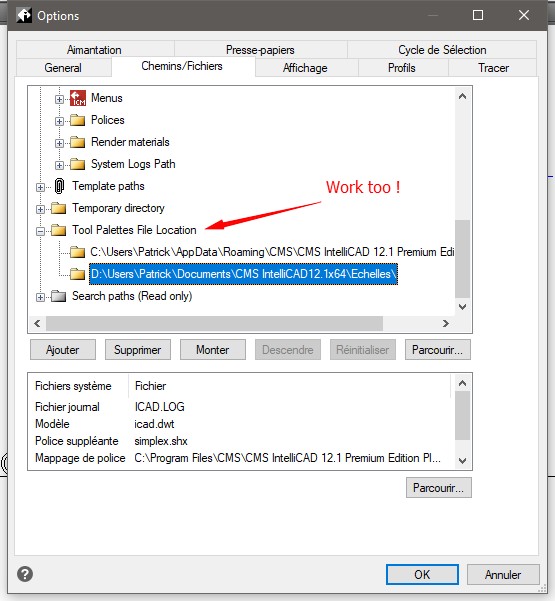

I mean for his problem he must install his lisp folder in a script folder in my CMS documents like that (no right to write here ! ) :
