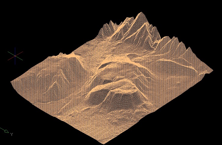

My First IRX routine, maybe useful for someone. I tried to attach it here but, I can't so I put it on my google drive
contains source and binary for 10_1, the command is make tin.
