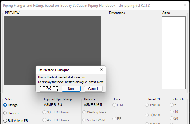

I use your SLN_PIPING lisp then try to replace your line
  (action_tile "s1"				 						;toggle Fitting options
		"(L1_ON)(L2_OFF)(L3_OFF)(L4_OFF)(L5_OFF)
		(L1_CLEAR)(L2_CLEAR)(L3_CLEAR)(L4_CLEAR)(L5_CLEAR)
		(RESET_LABELS)(RESET_DIMS)(RESET_LIST)"
	); END ACTION TILE
by this line
(action_tile "s1" "(nest1)" )
it works as below image.
