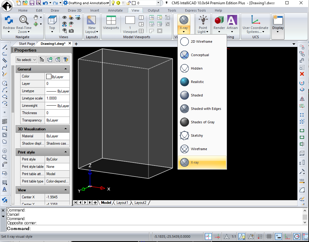

#4Hi,
You can use the command "vscurrent" or select the "Visuals Style" in the View menu.

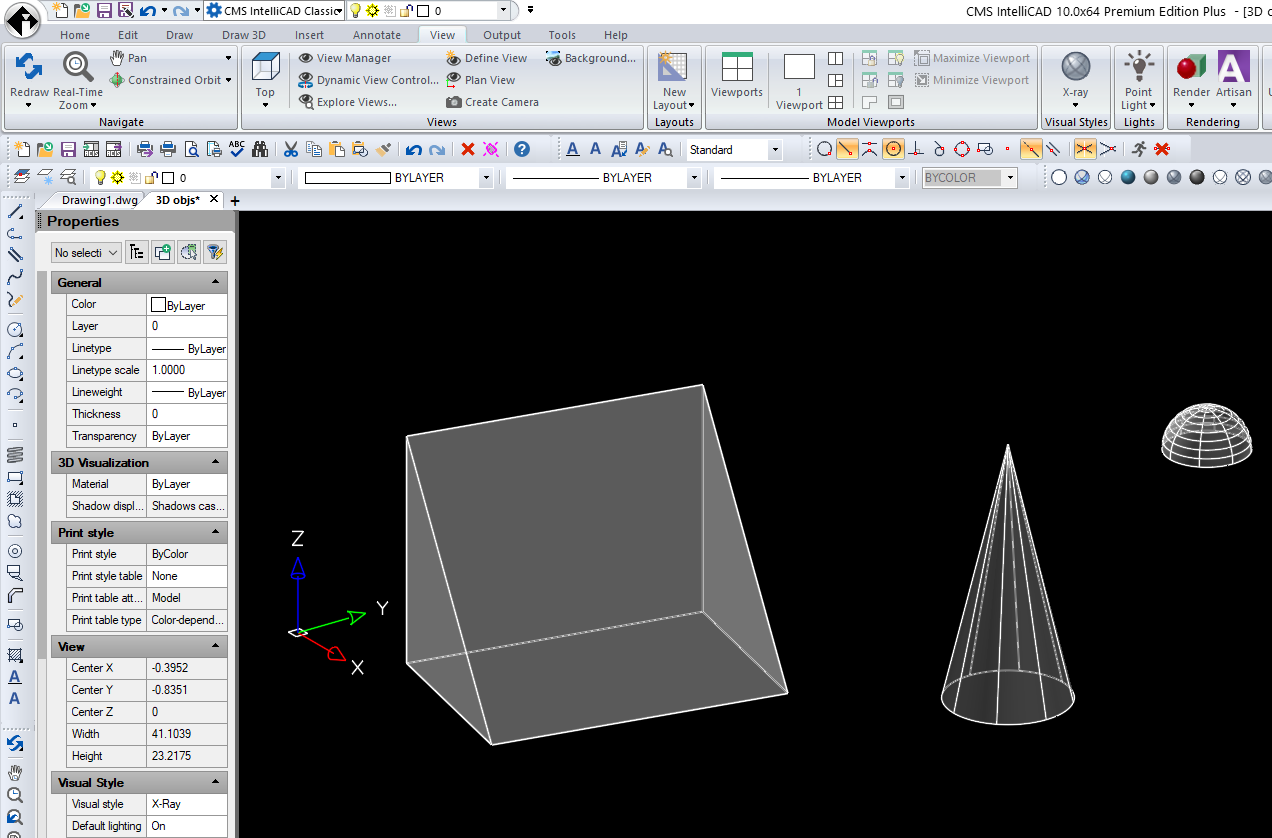

The X-ray and WireFrame work on my PC.
Please try to set the GRAPHICSCONFIG, refer here : viewtopic.php?f=4&t=1896&sid=4369f282a8 ... f24b5d230e
Or maybe it's the limit of the Trial version!
- XRay.png (150.78 KiB) Viewed 7352 times

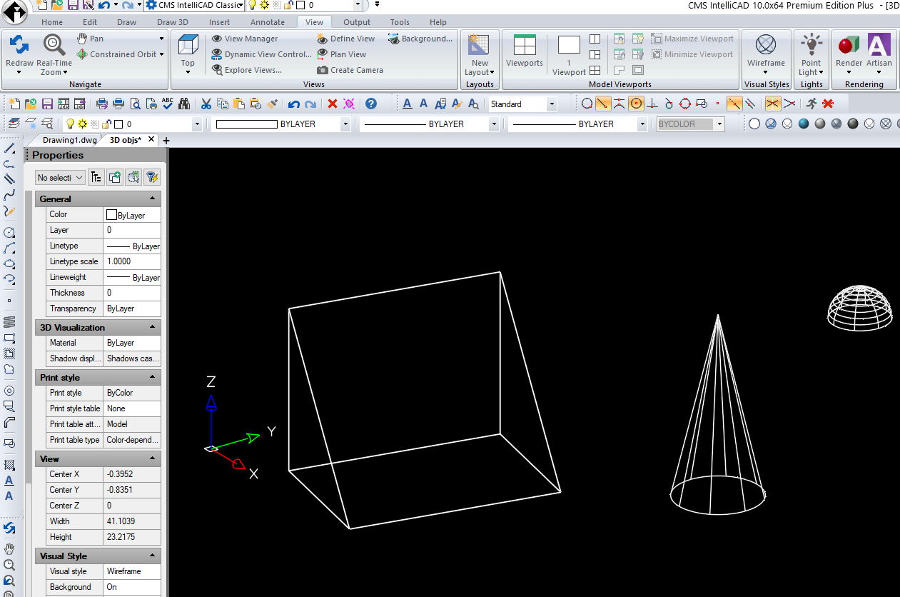

Re: New IntelliCAD PE plus install - trial - cannot see lines on black background
#7QuanNguyen, thank you this is solved! IntelliCAD defaulted to Open GL ES for embedded systems for some reason. I changed to Open GL standard and everything now displays. This seems to be a similar problem to what the person at the link had described. All visual styles now work and it is very clear.
