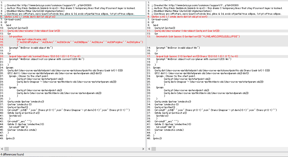

Re: Can someone fine tune this macro?
Try this:
(defun c:A2 ( / cmde deriv dist lst obj pt el ent)
(vl-load-com)
(if
  (and
    (setq lst (entsel))
    (setq obj (vlax-ename->vla-object (setq ent (car lst))))
    (or
      (wcmatch (cdr (assoc 0 (entget ent))) "*LINE,ARC,CIRCLE,ELLIPSE")
      (prompt "\nError: invalid object \n")
    (or
      (equal (cdr (assoc 210 (entget ent))) (trans '(0.0 0.0 1.0) 1 0 T) 1e-8)
      (prompt "\nError: object not co-planar with current UCS \n")
  (progn
    (setq dist (vlax-curve-getdistatpoint obj (vlax-curve-getclosestpointto obj (trans (cadr lst) 1 0))))
    (if (< dist (- (vlax-curve-getdistatparam obj (vlax-curve-getendparam obj)) dist))
      (progn ; Closer to the start point.
	(setq pt (vlax-curve-getstartpoint obj))
	(setq deriv (mapcar '- (vlax-curve-getfirstderiv obj (vlax-curve-getstartparam obj))))
      (progn
	(setq pt (vlax-curve-getendpoint obj))
	(setq deriv (vlax-curve-getfirstderiv obj (vlax-curve-getendparam obj)))
    (setq cmde (getvar 'cmdecho))
    (setvar 'cmdecho 0)
    (setq el (entlast))
    (vl-cmdf "_.LINE" "_non" (trans pt 0 1) "_non" (trans (mapcar '- pt deriv) 0 1) "_non" (trans pt 0 1) "")
    (while (setq el (entnext el))
      (entdel el)
    (vl-cmdf "_.arc" "")
    (while (> (getvar 'cmdactive) 0)
      (vl-cmdf "\\"))
    (setvar 'cmdecho cmde)
  (princ))
