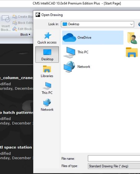

Onedrive is accessible when opening files within CMS IntelliCAD as long as Onedrive is properly set.
Also notice that it's not recommended to work directly on CAD files saved at a file hosting service and synchronization service like Onedrive or any other.
File corruption events may occur when CAD files are opened and the file hosting sync service ins not paused.
