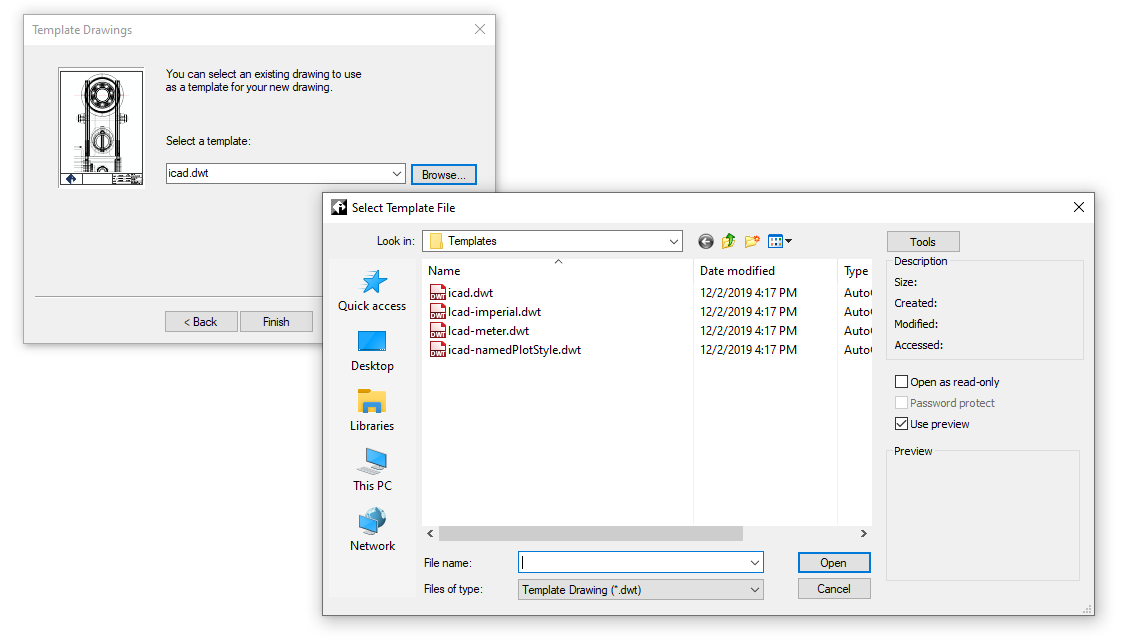

At a blank drawing, I believe you can set the default dimension style with specific ANSI dimensions settings and then overwrite the icad.dwt default template (ore create a new one).
Each time you create a new drawing (NEW command) then such settings will be loaded by default.
