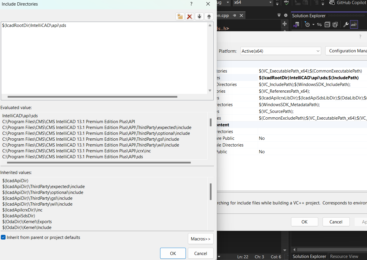

Hi all, when you open an IRX (or icrx) sample program in visual studio and look at the solution properties, you can see that there is a bunch of intellicad related filepath macros and default paths loaded into the program. For example, looking at the VC++ include directories there are quite a few 'inherited' paths and macros, I have attached an image of what I'm talking about.
My question is, how do I import or inherit these default paths and macros into a new solution? I am certain I can do this without entering all of these manually, these paths must be stored somewhere?

Please refer to the *.props files included in the sample solution.
For example: IntelliCAD.IcArx.Samples.props in icarx folder.
Thankyou for the response, it isn't a total setup for the API but it definitely helps to use this props file. I have worked on IntelliCAD quite a bit before with a company, but I never had to set up the environment from scratch, so this is all new to me.
