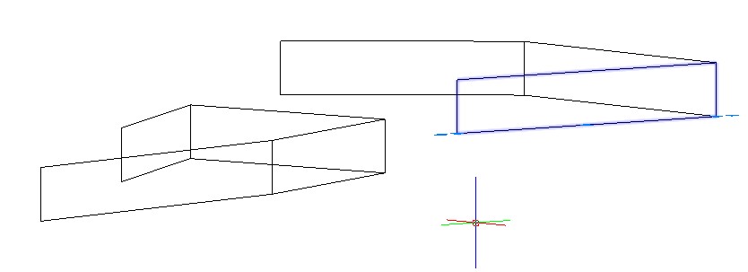

I understand your explanation of Thickness from your previous post, thank you for that. However, I also use a similar Layer creation strategy, but I do not understand how you can give a Layer a thickness.
Architectural Building & Interior Designer, AutoCAD since 1995, ArchiCAD in 2007 then Revit since 2012 😎🤙🏼
CMS IntelliCAD 11.1.435.145443.PE+.VC16.x64.CMS111
Dell Optiplex Intel(R) Core(TM) i9-10900 CPU @ 2.80GHz, Windows 11 Pro
Re: Multi-Level Building - CAN'T DO IT? CAD For Architects.....
#17
Format > Height
Format > Thickness
The Height of a layer is setup with the objects on this layer.
The thiskness of the layer is the same.
Before you draw; make sure you are on certain layer (for example on the first level) and if you set the height to 0.00 m, the line you draw will be placed at this altitude 0.00 ! If you have setup the thickness before with 2.80m, this line will be thick in 3D like this
Then if you draw on the second leve'sl layer; change the height to 3.2 m but don't change the thickness, ..... and draw your line on this second level's layer. Here is the result in 3D:
like that your drawing will be thickness in 3D. It's the old method of AutoCAD a lot of years ago.....
