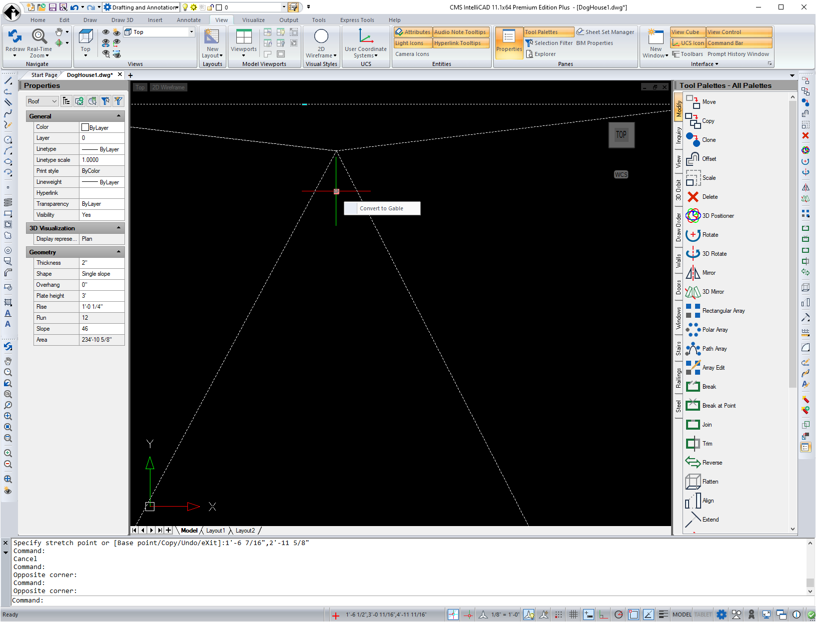

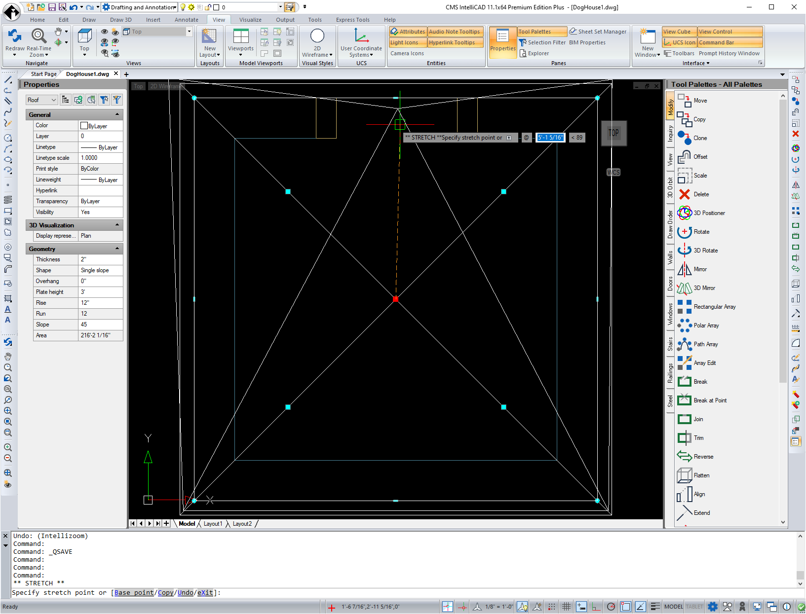

Drag center point to end where gable is desired

escape and reselect roof point near desired gable and use down arrow to select convert to gable

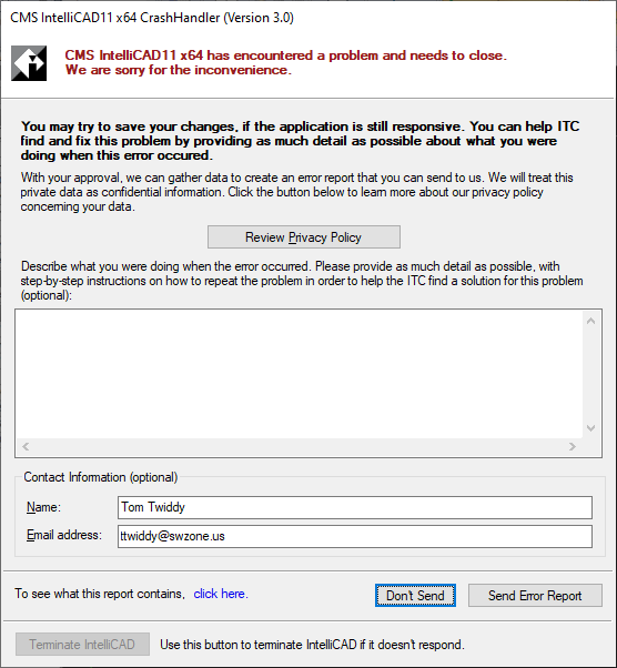

Submit crash report
Submit crash report

a) I selected the center point and dragged it towards the top wall.
b) I then reselected the roof and the draggable point nearest the end I want to be a gable give an option "Convert to Gable", using the down arrow I selected this and press enter
c) Intellicad crashes and I send the crash report

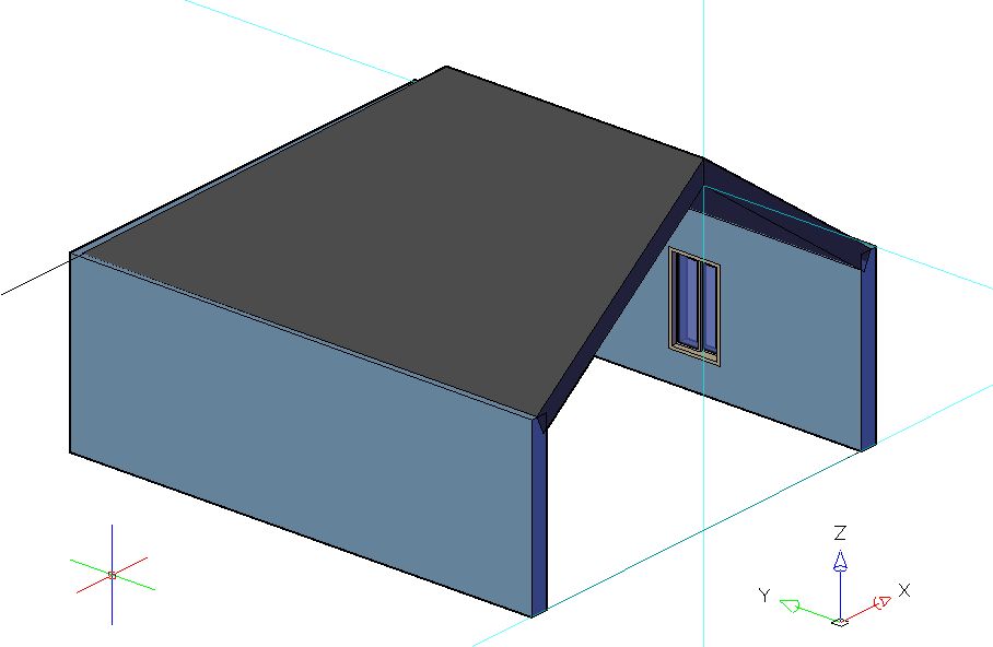

Hi Tom3, sorry for the delay but I have problem with AEC entities on my french UI.
Here is the result with a lot of efforts :
You must make roof as you said but after that you must explode your bad roof and select each Polyface mesh and build your seff your pinion.
And after that re-joint all polyfaces together.
EDIT: Off'course you lose the AEC properties. AEC Entities are not very developped in IntelliCAD.
EDIT: To joint each polyfaces's meshes together you must group them in Modify > Objects's group > Quick group
