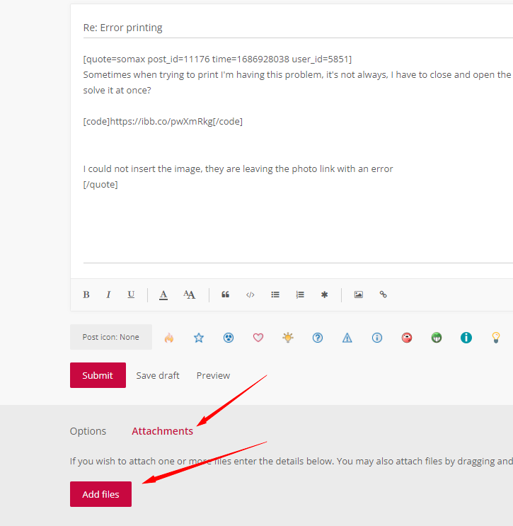

I could not insert the image, they are leaving the photo link with an error
and then: Insert this image in your text with this feature :
