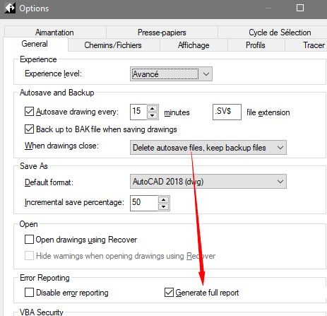

Yes I have :

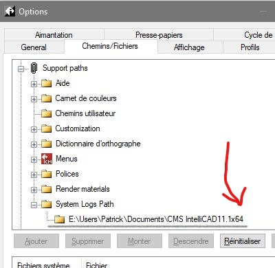

and go to the folder where you save your log files :
Draw your circles and close IntelliCAD.
Then open your log file after you have made these several 3 centers circles !
May be your errors will be written in this file !
