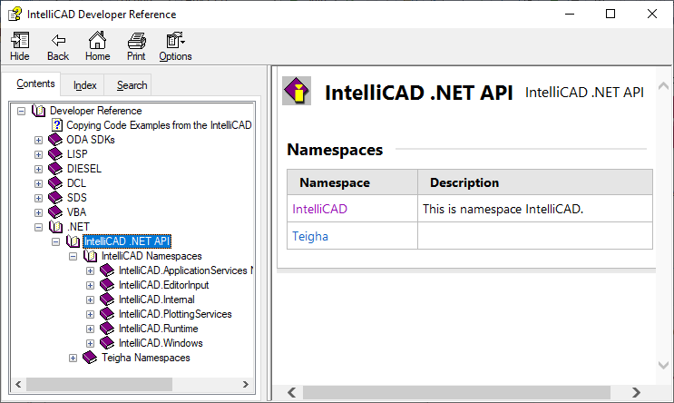

Re: Retrieve the Value from Custom Drawing Properties ACAD->ICAD
#4 by QuanNguyen
I mean the IntelliCAD .NET API, which is included in this software.
IntelliCAD NET API.png (25.56 KiB) Viewed 20444 times
