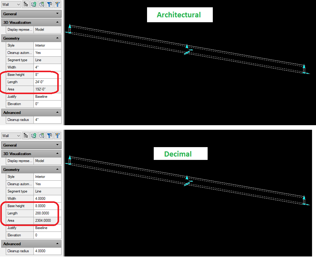

when I select a wall, the dimensions of the wall show correctly, however the conversion to square feet for area is incorrect. In the example image I show an 8 feet wall by 24 feet long. That should equal 192 square feet - NOT the 2304 feet shown. When I use scientific in inches it shows the same wall as 96 inches by 288 inches and calculate the square inches as 27,648 square inches (which is correct). To convert from square inches to square feet you divide the square inches by 144 (not 12).
I should also note - when I change from Decimal (inches) to Architectural and select "feet" as the units, my walls are deleted from the drawing with no warning or messages in the command line.

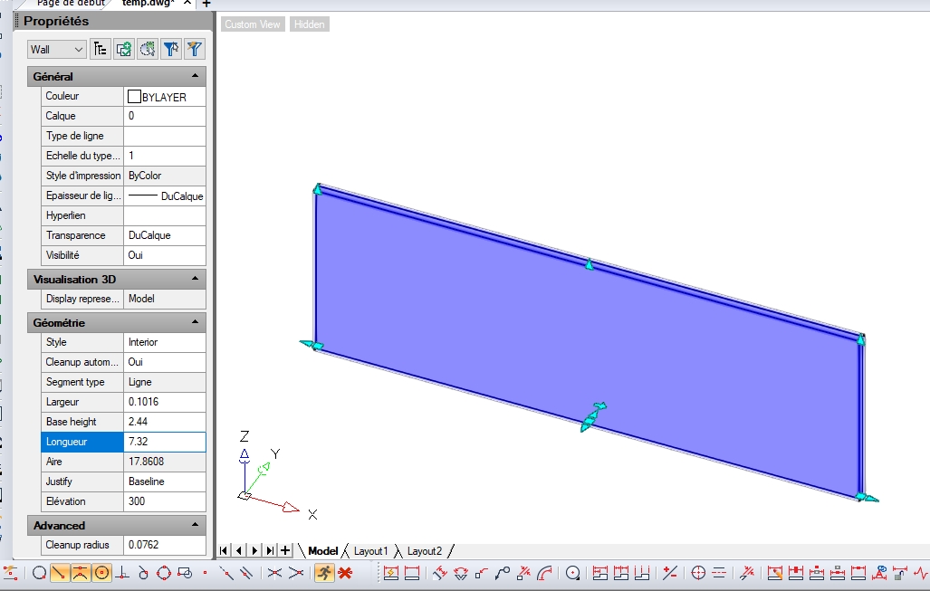

What is the nature of your wall, please? 3D Solid or AEC ? Your wall isn't created in IntelliCAD : Standard??? AEC Walls are exterior or interior!
Here AEC Interior :
8 feet x 24 feet = 2.444m x 7.32m = 17.86 m2
8 feet x 24 feet = 192 feet square or 192 x 0,093025m2 = 17.8608 m2

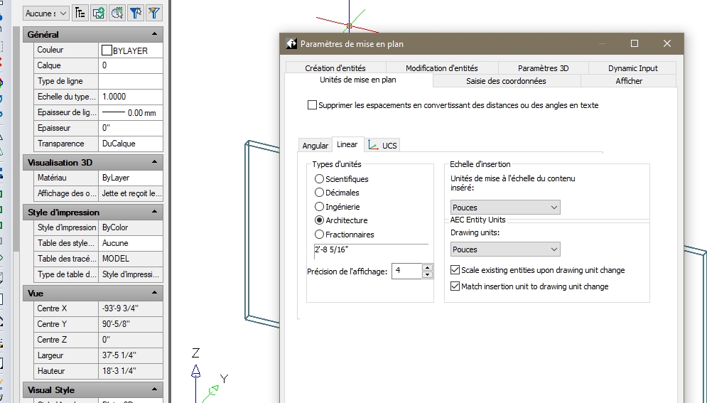

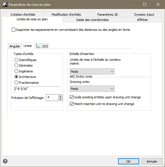

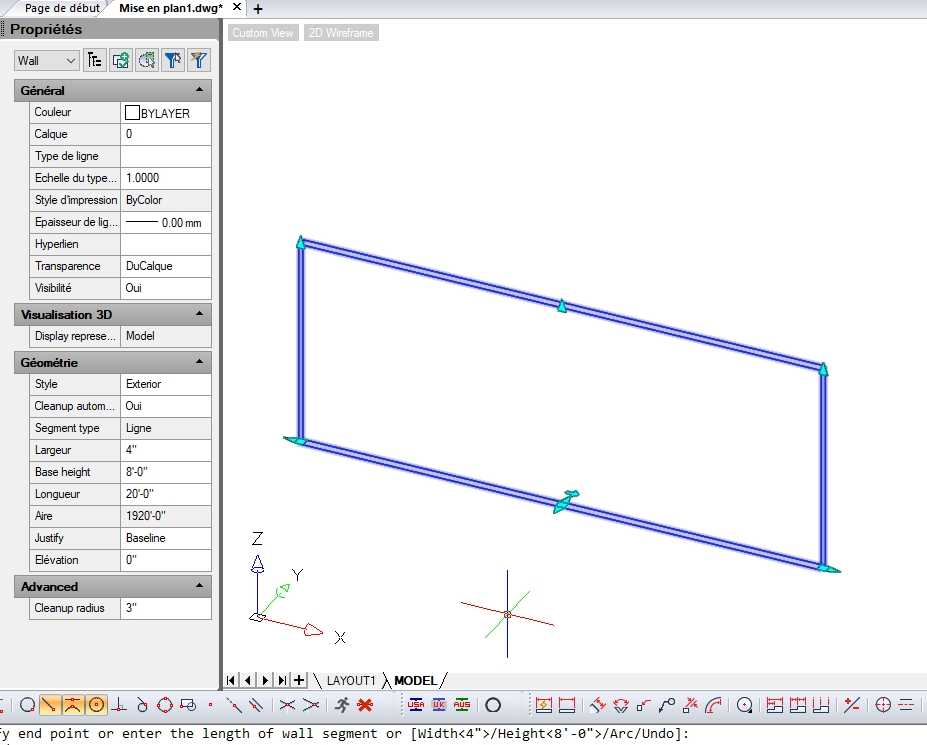

Drawing an Exterior AEC Wall, using FEET and AEC linear dimensions:
Results: 8' (ft) x 20' (ft) wall is 1920' (ft)
If I change to DECIMAL units:
The application displays INCHES even though it is set to FEET. The area in square inches is correct (for inches), but not for feet
I have tried reinstalling the application. If I create a new drawing using the guide and select METRIC, I don't get metric screens or units - they are still IP. There are a bunch of issues with this app, that are really frustrating....

I tried in Inch but no change the result is 1960' 0"
Even I change the AEC units !!!! Same result : 1960 feet at the place of 1960 inch!!!!
If I list the information:
Commande: _LIST----------------------- AEC_WALL ----------------------------------
Poignée: 537
Espace actuel: Espace modèle
Calque: 0
Couleur: DUCALQUE
Type de ligne: BYLAYER
Epaisseur de ligne: 0.00 mm
Style: Exterior
Segment type: Line
Width: 4"
Height: 8'-0"
Length: 20'-0"
BUT the area is not in the list!!!
I tried in metric and the résult is exact : 2.4384m x 6.0960 m = 14.8645 m2
