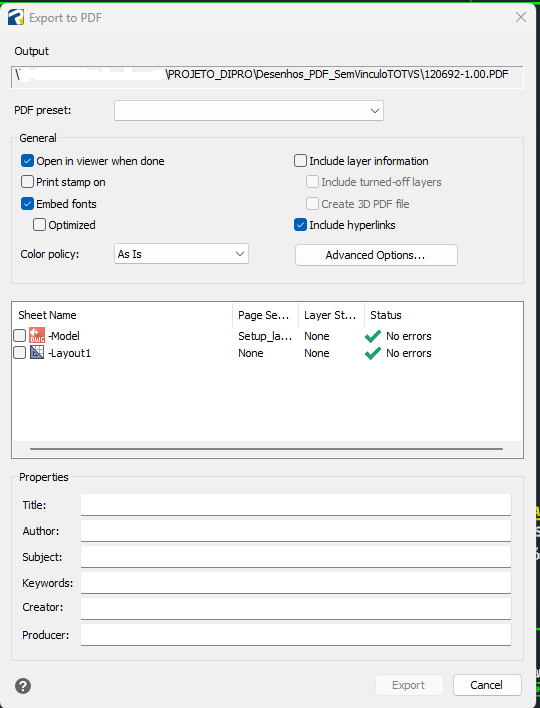

Anyone has a peace of code that export a dwg file to a pdf file, I came of a AutoCad world, I tryed to adapte to a VBA code to Intellicad but It don´t work
