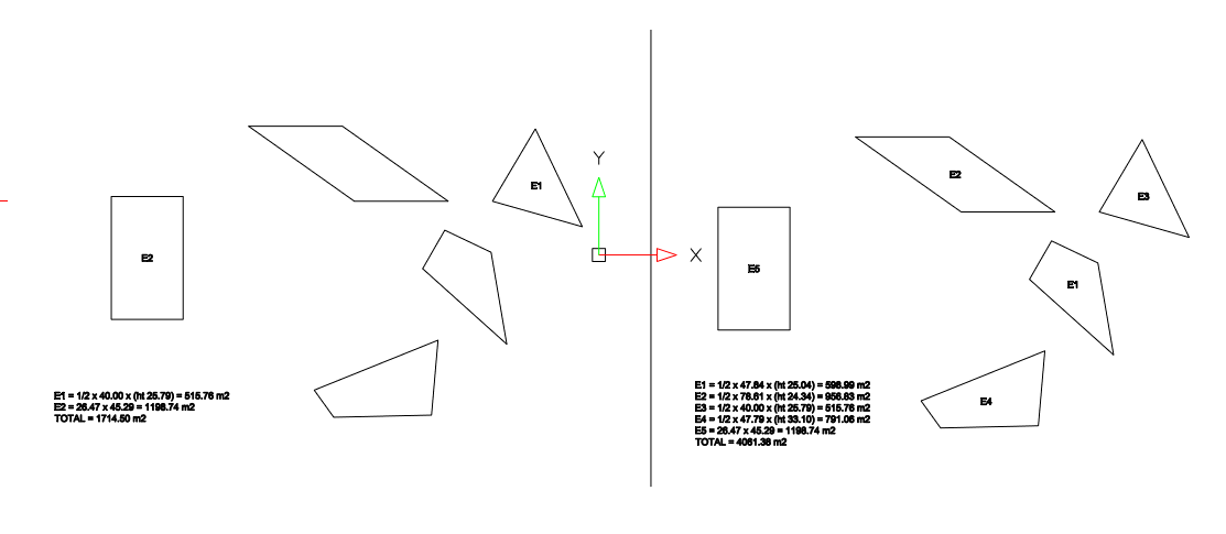

SPirou4D wrote: ↑
Fri Dec 23, 2022 4:53 am
BUT I can't remove to this problem :
Run-time error 87:
error: too few arguments
nil
If someone can help me to correct this Please !
Please replace the line:
(command "_.-style" "AREA CALC" "arial.ttf" 2.5 "1" "0" "n" "n" "n")
by
(command "_.-style" "AREA CALC" "arial.ttf" 2.5 "1" "0" "n" "n" )
and also IntelliCAD doesn't support some properties in the lines:
(mapcar
						'(lambda (pr val)
							(vlax-put nw_obj pr val)
						(list 'AttachmentPoint 'Height 'DrawingDirection 'StyleName 'Layer 'Rotation 'BackgroundFill 'Color)
						(list 1 (getvar "TEXTSIZE") 5 (getvar "TEXTSTYLE") (getvar "CLAYER") 0.0 0 0)
Re: Trapezoid area lisp
#17
Thanks you so QuanNguyen, you really follow me....
I tested your idea and now the popup to select new layer is deselected now! Thks
But I have yet one :
Run-time error 87:
nil
I changed this code:
(mapcar
	'(lambda (pr val)
		(vlax-put-property nw_obj pr val)
	(list 'AttachmentPoint 'Height 'Width 'color 'DrawingDirection 'EntityName 'EntityType 'StyleName 'Layer 'Linetype 'Lineweight 'Rotation 'BackgroundMask 'TrueColor 'Annotative)
	(list 1 (getvar "TEXTSIZE") "" 18 5 "Mtext" 23 (getvar "TEXTSTYLE") (getvar "CLAYER") (getvar "LINETYPE") (getvar "LINEWEIGHT") 0.0 "No" 18 "No")
with the list of all properties: (vlax-dump-object nw_obj )
but no changes.
#18
BUT I can't remove this "too few arguments!" problem .
Certainly in this code :
(setq
	ent_text (entlast)
	dxf_ent (entget ent_text)
	dxf_ent (subst (cons 90 1) (assoc 90 dxf_ent) dxf_ent)
	dxf_ent (subst (cons 63 255) (assoc 63 dxf_ent) dxf_ent)
For me, Lisp is more complicated than perl or python....
#19
Yes, you need to check if the dxf_data existing the 90 and 63 dxf codes before trying to replace them.
I bypass some lines (set/change properties) and it works now.
#21
Here is the last release of this script with the choice of calculation of Trapezoids :

											nil
									d2
									(distance
										pt4
										(inters
											pt1
											pt2
											pt4
											(polar pt4 (+ (angle pt1 pt2) (* pi 0.5)) (distance pt1 pt2))
											nil
									ht 	(atof (rtos (+ d1 d2) 2 4))
									surf (* (atof(rtos max_diag 2 4)) (atof (rtos ht 2 4)) 0.5)
									cum_area (atof (rtos (+ surf cum_area) 2 4))
								(strcat
									"E" (itoa (setq count (1+ count))) " = "
									"1/2 x "
									(rtos max_diag 2 2)
									" x (ht "
									(rtos ht 2 2)
									(rtos surf 2 2) " m2\\P"
					app_txt (strcat app_txt val_txt)
				(entmake
					(list
						'(0 . "TEXT")
						'(100 . "AcDbEntity")
						(cons 8 (getvar "CLAYER"))
						'(100 . "AcDbText")
						(cons 10 pt_ins)
						(cons 40 (getvar "TEXTSIZE"))
						(cons 1 (strcat "E" (itoa count)))
						(cons 50 (angle '(0 0 0) (getvar "UCSXDIR")))
						'(41 . 1.0)
						'(51 . 0.0)
						(cons 7 (getvar "TEXTSTYLE"))
						'(71 . 0)
						'(72 . 1)
						(cons 11 pt_ins)
						(assoc 210 dxf_ent)
						'(100 . "AcDbText")
						'(73 . 2)
			(setq nw_obj
				(vla-addMtext Space
					(vlax-3d-point (trans (getvar "VIEWCTR") 1 0))
					0.0
					(strcat app_txt "TOTAL = " (rtos cum_area 2 2) " m2")
			(mapcar
				'(lambda (pr val)
				(list 'AttachmentPoint  'Height 'StyleName 'Layer 'Rotation )
				(list 1  (getvar "TEXTSIZE") (getvar "TEXTSTYLE") (getvar "CLAYER") 0.0 )
			(setq
				ent_text (entlast)
			(while (and (setq key (grread T 4 0)) (/= (car key) 3))
				(cond
					((eq (car key) 5)
						(setq dxf_ent (subst (cons 10 (trans (cadr key) 1 0)) (assoc 10 dxf_ent) dxf_ent))
						(entmod dxf_ent)
						(entupd ent_text)
			(setvar "TEXTSIZE" old_textsize)
		(T (princ "\nSelected items are invalid"))
	(princ)
;return on the layer 0
(mapcar 'setvar '("clayer" "cecolor" "celtype" "celweight") (list "0" "BYLAYER" "BYLAYER" -1))
(*error* "")
EDIT 1 : Corrected with more precise rounded result !
