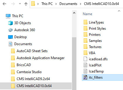

Where is filter.nfl or equivalent kept? I searched in OPTIONS/Paths/Files and didn’t see any, this was after creating a simple filter in hope it would create filter.nfl but after a deep folder explorer search, nothing. I'm assuming it is named the same as in Autocad. So I copied Acad’s .nfl to main icad folder where the .exe is kept, restarted icad, then at the command line: (findfile "filter.nfl"), it returned the path/file, "C:\Program Files\CMS\CMS IntelliCAD 10.0 Premium Edition Plus\filter.nfl" but will not load under “named filter/current”, it is empty. Any ideas?
Thanks,
R.L. Hamm
