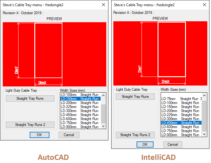

Re: Insert an Image into a DCL box
#7
Hi
Thanks for that, it's working now :)
The location for this was the missing link:
Code: Select all
  ) ;end if
  (SET_IMAGE)
  (action_tile "accept" "(exit)")
Now for me to try to add the sld image to the list file
("LD-900mm Straight Run 3mtr" "LD-900mm-tray-run-3000" "ldtr.sld")
("LD-750mm Straight Run 3mtr" "LD-750mm-tray-run-3000" "ldtr.sld")
and make that work. :)
S
#13
Try this:
- copy to previous code lisp.
- load and run the command : fredsingle4
Code: Select all
(defun DIALOG4 ()
  (setq DCL_ID (load_dialog "fredsingle2.dcl")) ;load the DCL file
  (if (not (new_dialog "fredsingle2" DCL_ID)) ;initialize the DCL file
    (exit) ;exit if this doesn't work
  ) ;end if
  (DEFAULTS)
  (action_tile
    "ldct2"
    (strcat
      "(setq newtile $key)"
      "(READ_DIM_FILE)"
    ) ;_ end of strcat
  ) ;_ end of action_tile
  (action_tile
    "ldct1"
    (strcat
      "(READ_DIM_FILE)"
    ) ;_ end of strcat
  (action_tile
    "get_size"
    (strcat
      "(setq index (atoi $value))"
      "(setq size (strcase (nth index display_list)))"
      "(DIM_LIST)" "(SET_IMAGE4)"
    ) ;_ end of strcat
  (action_tile "accept" "(CHECK_SELECTIONS)")
  (action_tile
    "cancel"
    (strcat "(done_dialog)" "(setq newtile nil size nil )" "(exit)")
  (action_tile "help" "(help)")
  (start_dialog) ;display the dialog box
  (unload_dialog DCL_ID) ;unload the DCL file
) ;end DIALOG
(defun SET_IMAGE4 ()
  (setq w (dimx_tile "imagekey")   		;get image tile width
        h (dimy_tile "imagekey")    		;get image tile height
  )						;end of setq
  (setq sldFile(nth 2 SIZE_DIMS))
  (if (not (findfile sldFile))
    (progn
      (alert (strcat "Not found file: " sldFile))
      (setq sldFile "default.sld")))
  (start_image "imagekey")			;start the image
  ;(slide_image 0 0 w h "50x50x6.sld")		;display a slide
  (fill_image 0 0 w h 9)
  (slide_image 0 0 w h sldFile)			;display a slide
  (end_image)					;end image
 ) ;End SET_IMAGE
(defun C:fredsingle4 (/ NEWTILE SIZE DISPLAY_LIST INDEX D DIM_FILE )
  (setq
    OLDERR *ERROR*
    *ERROR* ERR
  ) ;_ end of setq
  (setq OS (getvar "OSMODE"))
  (setvar "OSMODE" 111)
  (DIALOG4)
  (DRAW_SHAPE)
  (setvar "OSMODE" OS)
  (setq *ERROR* OLDERR) ; Restore old *error* handler
  (princ)
) ;end
